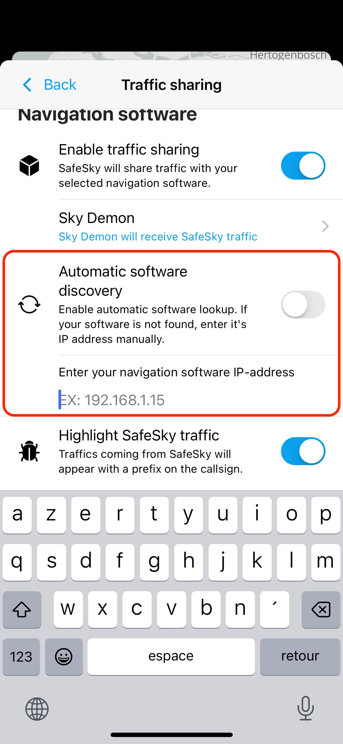

Android is always more complicated than iOS.
Probably an IP address issue…With iOS the automatic discovery of the IP address is ok. Not always with Android.
It means that you need to enter manually the IP address of your tablet and fill in in the trafic sharing menu.
Keep us posted !!
