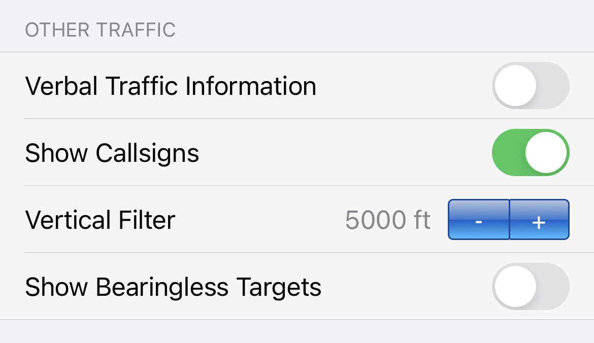

Do you confirm you started SkyDemon using GDL90?
If so, then SafeSky is communicating successfully to SkyDemon (since you have a GPS fix). Therefore, you need to check the filters on both SafeSky and SkyDemon that could prevent traffic from showing up.
1 - In SafeSky the bottom left icon: the radar filters out traffic from below and above 2000 feet by default: maximise this value for the sofa test
2 - In SafeSky traffic sharing: set the “Traffic range” to max.
3 - In Sky Demon, navigation options: ensure that the vertical filter is greater than 5000 feet
I would expect traffic to appear in SkyDemon.
Please let me know,
Tristan
Thanks - it now works in sofa mode

Does this mean SkyDemon will not show traffic higher than 5000 ft when doing a sofa test on MSL?
Found the answer myself. This morning there was some traffic within 43 NM below 5000 ft. It was visible in Skydemon. The sofa test was successful! Now to test it in flight next.
