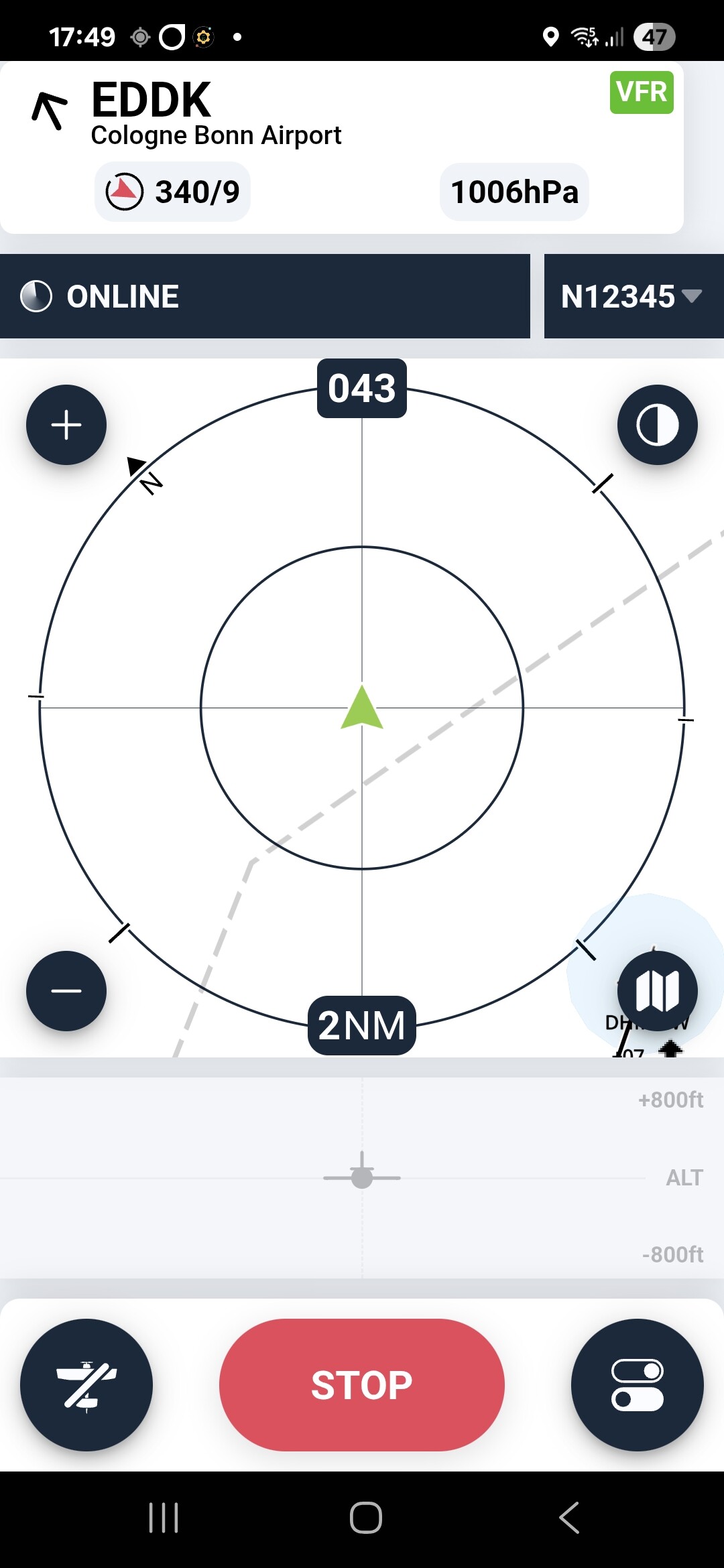

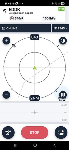

It’s exactly in this screen, where the problem occurs.
On the last 7 days we flew a lot as a formation of 3 planes.
And at the beginning i could see all of them. (And thankfully now I can mute aircrafts, differently than 2 years before. Thanks for adding this feature!).
But after quite some time (i can’t tell you a number. Maybe 30 minutes to 60 minutes?) all the other aircrafts suddenly disappear from the screen.

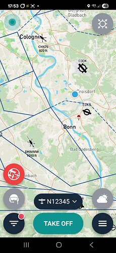

But when I push on STOP and get to this screen …
… I could see them again.
And even when I then press on takeoff again, they are visible in the radar view as well for some time…
