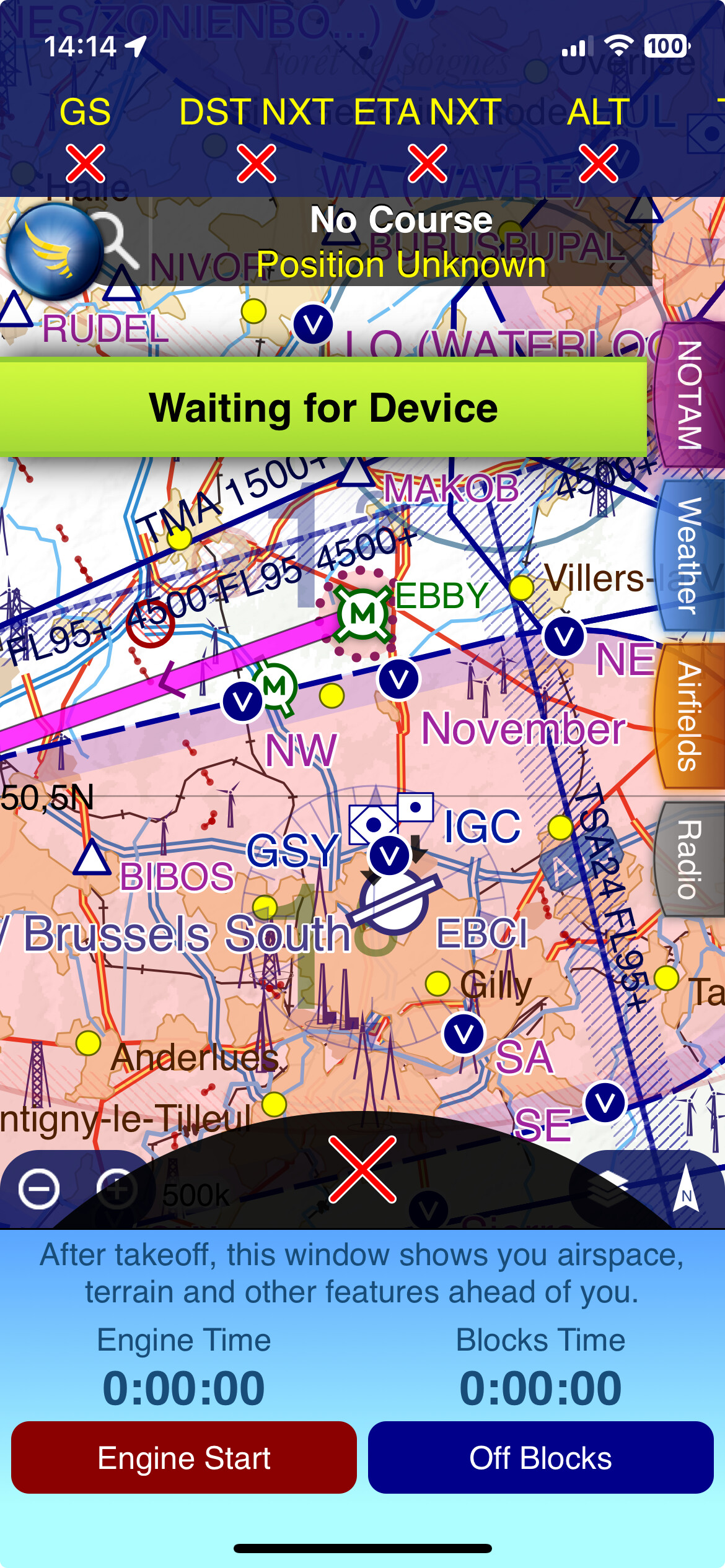

Thanks for the feedback. Are you able to reproduce from the ground too, or only in the air?
And can you confirm if it’s only traffic that disappear in SkyDemon, or are you getting the “Waiting for device” banner?
Tristan
In flight mode the same in air or ground
ok, and are you getting the “Waiting for Device” message, or just no traffic any more?
Only no trafic

I’m experiencing the following problem on my iPad mini 5: After a short time, SkyDemon reports “device lost.” SafeSky crashes in the background. After restarting SafeSky, I can switch back to SkyDemon and the connection works again, at least temporarily.
Do you have any suggestions for resolving this issue?

Hi Tristan,
I have the same issue and it’s on an iPad mini 5.
The device connection is lost and does not come back, even when switching back to the safesky app. Only when safesky is restarted does it start working again.
