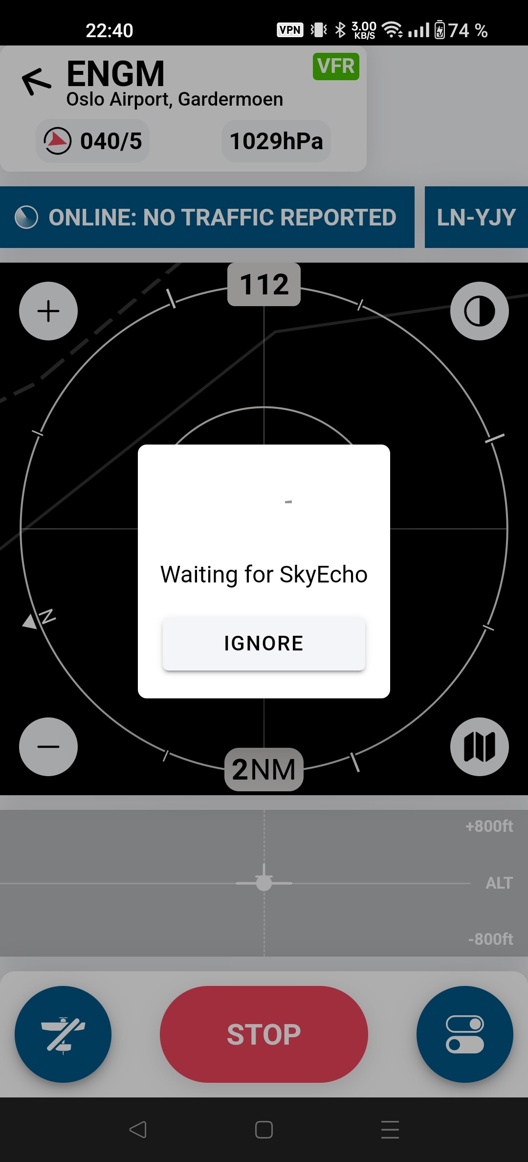

I use a OnePlus 8 pro with Android 13. I am unable to use mobile data when connected to Skyecho wifi.
As a workaround I use the Speedify app to be connected to both…

I can now see traffic in Skydemon. However I get this message in Safesky saying “waiting for Skyecho”
I have checked all the settings and the setup should be fine…
How do I resolve this?

I also has the “Waiting for Stratux/Ignore” message. It is a bug I am waiting to be resolved by Safesky team, but because I’m using Skydemon as traffic display source, i dont care a lot of this issue.
